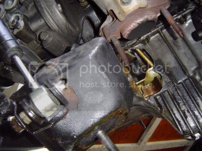

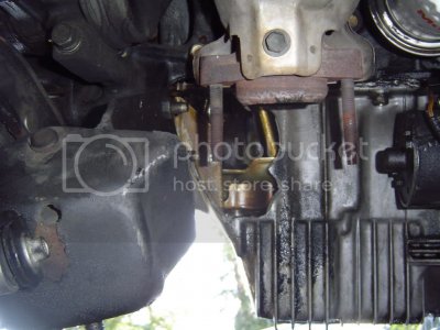

Is that part of the tranny broken off? If so, where did it break?
Randall
Oct 28, 2004
248
17
San Jose, California
Yep, it is the upper front portion of the oil pan, which is one of three broken pieces. I plan on pulling it this weekend, so watch for the pics, they are quite horrid! As far as the tranny shop goes, they said they would cover 1/2 of the price of a USED engine if I brought down the clutch assembly and they could verify damage from being misaligned. We'll see what happens with that.
