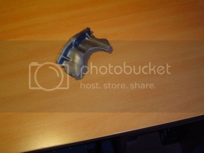

Well, the source of the noise revealed itself, a picture says a thousand words, right?
SHOdeath
The noise had actually gone away the past couple days, then in a 5 second time frame while coming down the freeway it suddenly sounded like marbles being thrown into a ***, and bang! The tow truck driver said I should go after the tranny shop because we talked about how the tranny was a 1/2 inch below the engine with the missing bolts, and he said that the non-centered force of the input shaft caused premature wear on the bearings..... it sounded good to me, but right now I am so depressed with the loss of my SHO that I don't know what to do. What do you guys think? Anyone know where to find a good running engine in California?
