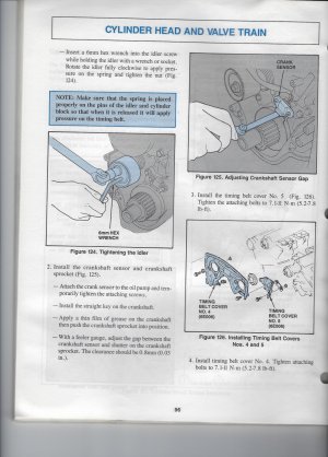

make sure to properly gap it and use both stainless steel screws to hold it in place
clayb226
Aug 12, 2009
103
11
Missouri
Yeah, I was just getting ready to ask about this, it seems like no matter what I do, the sensor screws are at the bottom part of the adjustment?
Sent from my SM-S236DL using Tapatalk
