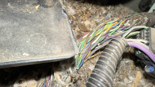

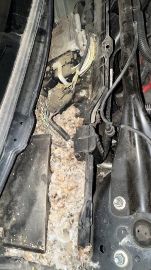

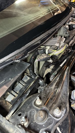

i need to post a pic... bc damn. it was mouse damage like i was afraid of. pulled the wipers and cowling etc to get to the pcm after replacing the crank sensor changed nothing... they chewed 9 or 10 wires partially bare and cut thru several wires to the pcm. i probably got lucky nothing worse happened.
spent about 5 hours cutting/splicing and soldering and shrink tubing everything and another couple cleaning it all out before that. i dislike the fact that the pcm was placed in such a bad spot where predictably the mice would go near the fresh air intake for hvac. do these final gen of taurus suffer from the same soy based wire jacketing as others i read about?

i didn't really see a way to remove that tray that covers the fresh air intake for hvac in the FSM. looks like its glued down pretty hard anyway so i guess maybe its not meant to be removed... but would be nice to be able to pull that and the screen and clean from that end periodically. thinking i might get creative with the hardware cloth after this and repellent? i cleaned the **** out of it but i know they like to come back to the same spot anyway.
