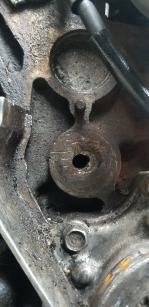

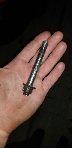

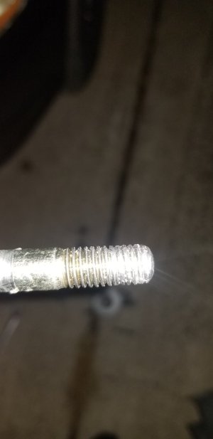

I got those put on and it did start but then immediately after the timing tensioner fell off will post pics but I dont think this is right

Ouch! I've seen studs snap before but I've never seen one ripped out like that.

The only time I've seen the tensioner bolt snap was because the nut wasn't tightened down or the tensioner was set too tight on the belt. Do you remember setting the tensioner by rotating the crank twice and then tightening the nut?
This looks like it will need to be welded and tapped.

Not sure on the timing procedure my grandpa did it while I was at work... is the white mark on the crank pulley the first or second mark theres no paint left on mine trying to redo timing on it now had a friend weld a new stud to the block

Install the timing belt and release the tensioner pulley so the spring pushes the pulley against the belt. Do not tighten the nut yet. Rotate the crank by hand two full revolutions. Now tighten the nut on the pulley stud to lock the pulley in place.
