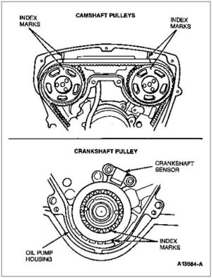

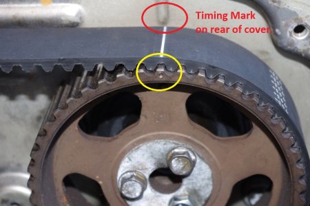

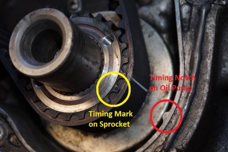

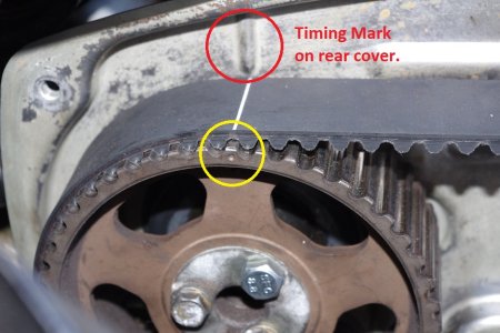

There is no timing procedure. Install the timing belt with the crank and cam sprockets lined up like they are supposed to be and then that's it. This isn't a small block Chevy where you need to adjust the distributor afterwards. The cam sensor and crank sensor do the timing electronically. Install the belt properly and go.
