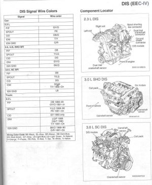

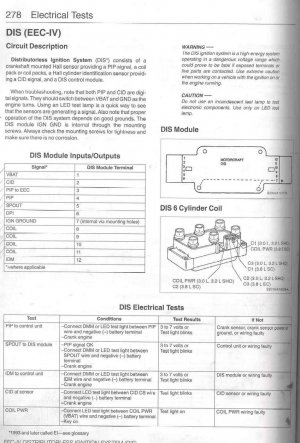

The DIS Module is grounded by the bottom two bolts holding it on. Check for continuity between one of those bolts and B-.
View attachment 86797View attachment 86798Ignition circuit for a '94. Close enough to a 92.
I tested the ground like that the other day, and it was good, I also tested my ground strap, and the intake bolts, all good. Does anyone know if there's like a reluctant wheel or something that trips the signal on the cps??
