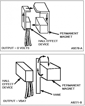

The sensor has a digital converter - the hall effect device in the sensor is used to trigger a switching output. When there is no magnetic field, such as when the vane of the camshaft or crankshaft is blocking magnetic flux from the permanent magnet, the PIP output signal will be 12V, the battery voltage. If instead, there is no vane, and magnetic flux from a permanent magnet is held near the sensor in similar configuration and N-S alignment, the output will switch to zero volts.
VEKQqBI
One can set up an apparatus that will power the CPS with battery voltage. Then create the pulses, via (edit) ferrous metal like the crank vane that interrupts the gap. Then see that the correct PIP signal output pulses are generated, perhaps with an oscilloscope instead of a test light or multimeter. If you don't get the expected output, you'd need to see that your methodology is correct with a known-good sensor.

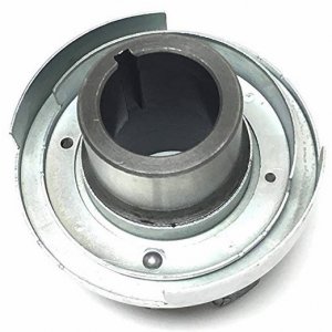

With similar wiring, the Ranger CKP has an integrated magnet in the center, and the sensor has two vane slots, each with its own output, with sensors on the top and bottom. This includes the sensor for DIS ignitions on 89-93 Mustang 2.3l, Ranger 2.3L 89-98, Mazda B2300: (Ford/Mazda parts E9TZ6C315A F07E6C315AC F0TZ6C315B, F0TZ6C351A F1TZ6C315A F1TZ6C351A, F4ZZ6C315A F4ZZ6C351A F4ZZ9C351A, ZZMO18082 F0TZ6C315C F27E6C315BA, ZZM018370 PC10 5S1744 SU221 CSS60)
Here is testing this sensor:
The 2.3L's two hall sensors have quite different timing outputs, as can be seen by the crankshaft hub vanes:
8BHUtaN
It might be possible to cut off the bottom sensor, and use the top for both PIP outputs on the SHO, rewiring the connector. However if such a modified sensor was mounted by the two bolts, the gap would be far too wide. One of the two sensors probably responds to reverse N-S magnetic polarity. The signal conversion circuitry is probably the full length of the body, prohibiting this anyway (along with the different shape back).

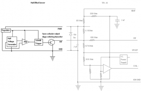

The digital-out Hall-effect sensor works similarly to the distributor PIP position sensors in the previous Ford TFI-IV ignition system. It has an analog-to-digital converter, outputting clean 12V or 0V. The hall effect sensor in our camshaft sensor and others also would have this required circuitry. The sensor circuitry is depicted on the left side of the image below:
Xp4gLLG
The circuitry on the left is likely all in one IC. The documentation for Standard Motor Product's sensors has fancy words like auto-adapting sensor logic, indicating their sensors (or whoever supplied Motorcraft and all others) may have more refined logic. That all different crank sensor part numbers and brands dried up at the same time lets us know there was only one real manufacturer of these sensors, or of the ICs needed.
