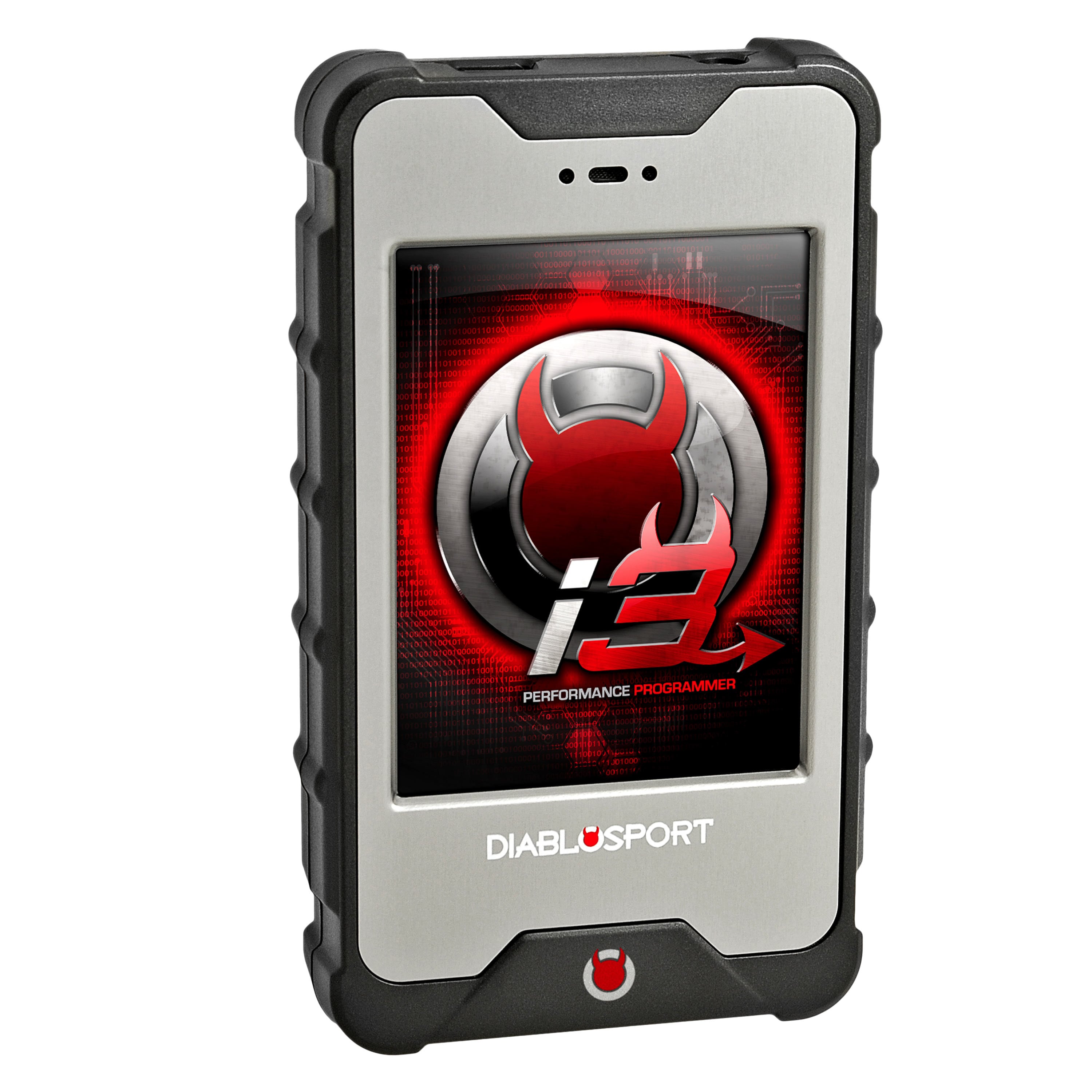

Im tyring to choose which tune I should go with for the best 93 Octane tune
Unleashed:
or
Diablo:
What do most SHO owner's go with?
Also how does the E85 fuel work for the SHO? What kind of Tune should it take and why do so many people prefer it over 93 Octane tunes?

I'd definitely recommend sticking with a tuner that offers SCT support, much more options that way if you aren't happy. Very few people are still using the Diablosport system, so much like LMS's handhelds, if you aren't happy it's an expensive road to try something/someone else.
