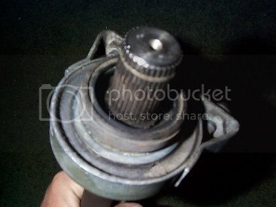

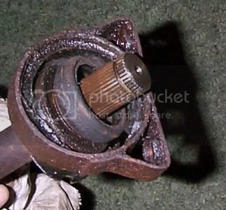

Was it as bad as mine?
DCP01154
My used replacement looked like this...consider it a point of reference.
DCP01155

I woulld say yes, my bearing looks like your bad one.
