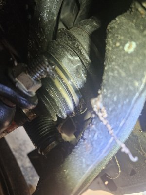

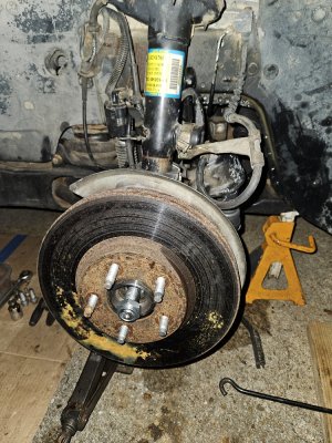

Here are some pictures of the axle boot with grease that has been leaking out.

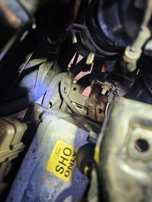

One thing that I see that has to be wrong, is the routing of what looks to be a heater hose of some sort. What is this exactly?
I had a new transmission installed back in 2019 and have put less than 500 miles on the car since the installation. I replaced the wheel bearing/hub assemblies a few years ago also and did not notice the hose at that time, don't know how I missed it. It looks to me like that hose should be on the other side of that mount and behind the fender liner. Can someone confirm this and let me know what this is? Thanks. 13817c80662c97c519a7dac6451efc82E2f384cbc18271f5cb7425ea8aea0dd28c657409d49df5cbb5f3d4413960ef0e69860f9dc94e4fa158bb021ef0c39506B677a11c069d653a2da26dd5ba6ee9ce

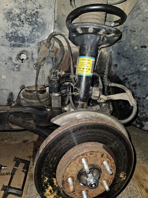

What a pain in the butt!!! I watched a video of a guy replacing an axle in a Taurus and it looked pretty straightforward, but here's the kicker, it was a regular Taurus. The struts on the SHO are different, I am wondering if they may be a little longer because man, it was a struggle to get the strut out of the steering knuckle/spindle. Once I got the strut out, I was able to get the axle removed and got the new one in. Now I am fighting with the knuckle and strut again. I will hopefully finish it up tomorrow, I think that separating the ball joint will make things easier.
I also found that the mystery hose was routed correctly but had fallen down so it has been placed back up where it belongs. I don't know what it is exactly though. It comes from the front of the transmission and then disappears behind the transmission somewhere, I haven't been able to trace where it goes yet. Anyway, I removed the front half of the fender liner and put the hose back where is is supposed to go.

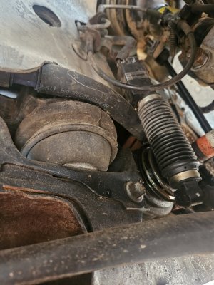

Update. The strut is in the knuckle and the axle is in. I installed a new ball joint as well as a new tie rod end, both boots were looking worn so, why not. All nuts and bolts have been torqued to their respective specifications also. I just have the caliper bracket, caliper and pads and a brake line bracket left to install, then finish installing the axle nut and torque it to spec, put the wheel on and go for a test drive. I plan to do all of that in the morning.

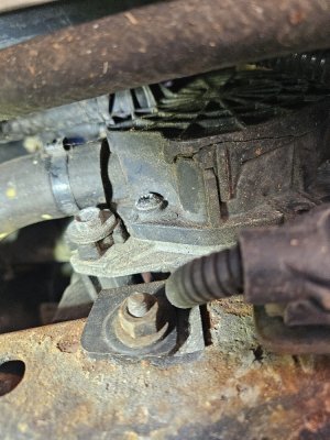

I was able to put the mystery hose back in place also and I am including some pics. I don't know what this thing is, but the hose connects to this thing with a band that you cannot remove. The thing is located below the battery tray bracket and near what I believe is the ABS pump. 4710ee51c71972ade9373fbf9e5c8532104e521a626a3f6b662d5f506aba1a1f00dbb6f8ccb7b5fc5f397159ddfbd62079d473cd7ff0574a5803b2329c0c59f1F0951995fa9e70bc7ea8f2ab654e7b183cc94cf040d20f4753ed2028f5daeb65

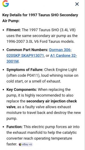

Hi Marty -
That mystery hose is the SAI - Secondary Air Injection.
Okay. What exactly does the SAI do? So, the hose only has air going through it?
Okay I found this information about the SAI. That's good to know. The hose had fallen down and was rubbing on the axle shaft. When we first drove the car the other day I smelled a burning rubber smell. When I relocated the hose back to where it needed to go I found a small area on the hose that showed where it had been rubbing but had not made a hole.
Sent from my SM-S916U using Tapatalk
35908ae7535657148e67bb20bdf7e19d
E1
Crash Tested
Jan 24, 2003
784
516
Chicago area
Half the time that pump, or its relay are dead. No effect on operation or performance but it will throw a code for emissions which might matter if you are in an emissions compliant state like California or Illinois, etc.
Only operates for 30 seconds or so after a cold start. One will hear a whirring sound by the front bumper if it is still operational.
All it does is pump air at the cold catalytic converters to make them warm up more quickly.
Not a worry for the safety of the engine.
