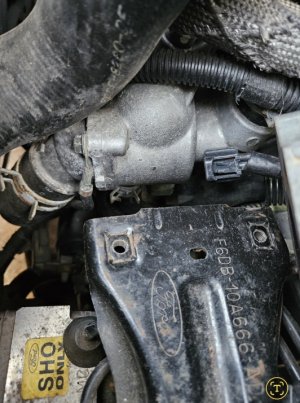

I didn't realize until just now that I have a picture of where the thermostat is located. This picture shows the black metal bracket that the battery tray bolts to. It shouldn't be too difficult to replace the thermostat after all. Good times!!! Fd0e97c98d36363f157932d74656202a

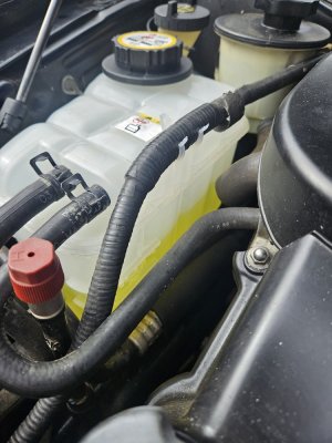

It is nice to be able to see how much coolant is in the tank now.
Sent from my SM-S916U using Tapatalk
66e9ecc78ed22cefd56f1b493b41c9e6
Posted the pic twice by mistake and can't seem to delete it. Oh well.
