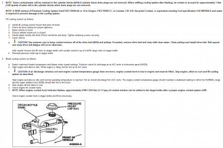

1997 Taurus/Sable
3.4L SHO
Removal
    WARNING: NEVER REMOVE THE PRESSURE RELIEF CAP UNDER ANY CONDITIONS WHILE THE ENGINE IS OPERATING. FAILURE TO FOLLOW THESE INSTRUCTIONS COULD RESULT IN DAMAGE TO THE COOLING SYSTEM OR ENGINE AND/OR PERSONAL INJURY. TO AVOID HAVING SCALDING HOT COOLANT OR STEAM BLOW OUT OF THE COOLING SYSTEM OR DEGAS BOTTLE, USE EXTREME CARE WHEN REMOVING THE PRESSURE RELIEF CAP FROM A HOT COOLING SYSTEM OR DEGAS BOTTLE. WAIT UNTIL THE ENGINE HAS COOLED, THEN WRAP A THICK CLOTH AROUND THE PRESSURE RELIEF CAP AND TURN IT SLOWLY UNTIL PRESSURE BEGINS TO RELEASE. STEP BACK WHILE THE PRESSURE IS RELEASED FROM THE COOLING SYSTEM. WHEN CERTAIN ALL PRESSURE HAS BEEN RELEASED, PRESS DOWN ON THE PRESSURE CAP (STILL WITH A CLOTH), TURN AND REMOVE PRESSURE RELIEF CAP.
    Drain the engine cooling system so that the engine coolant level is below the water thermostat.
  2. Remove battery (10653). Refer to Section 14-01 .
  3. Remove power distribution box.
  4. Remove battery tray (10732). Refer to Section 14-01 .
  5. Disconnect upper radiator hose and position out of the way.
  6. Disconnect the lower radiator hose from the water inlet connection (8K528).
  7. Remove the two retaining bolts. Remove the water inlet connection.
  8. Remove the O-ring seal and water thermostat from the water pump (8501). Inspect O-ring for damage and replace if necessary.
  9. Thermostat
    1770695206588
    ItemPart NumberDescription
    18K528Water Inlet Connection
    2O-Ring (Part of 8575)
    38575Water Thermostat
    48501Water Pump
    5Stud Bolt
    6Bolt
    ATighten to 15-22 Nm (11-16 Lb-Ft)
    BTighten to 8-12 Nm (71-106 Lb-In)
Installation
  1. Install the water thermostat, O-rings and water inlet connection as illustrated.
  2. Install and alternately tighten the retaining bolts. Tighten bolts to 8-12 Nm (71-106 lb-in).
  3. Connect the lower radiator hose to the water inlet connection.
  4. Install upper radiator hose. Position spring clamp securely.
  5. Install battery tray. Refer to Section 14-01 .
  6. Install power distribution box.
  7. Install battery. Refer to Section 14-01 .
  8. Fill the cooling system with Premium Cooling System Fluid E2FZ-19549-AA or -B in Oregon, F5FZ-19549-CC, in Canada, CXC-8-B, Recycled Coolant, or equivalent that meets Ford specification ESE-M97B44-A in a 50/50 mixture with water as described under Cooling System, Draining, Filling and Bleeding procedure.
  9. Start the engine and check all hoses and connections for leaks. Allow the engine to warm up so that the water thermostat opens.
  10. Stop the engine. Top off degas bottle as required to maintain minimum cold fill level.

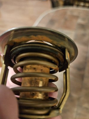

I removed the old thermostat today. This is a 180 degree thermostat. I'm not sure what the "96 10" numbers are and there is not a manufacturer name on it anywhere.
I have not installed the new one yet. I could not find a 192 degree thermostat so I went with a 180 degree one. I have owned this car since 2003 and have never replaced the thermostat so, it has had a 180 in it the whole time I have had the car. If you look closely you can see that this thermostat is actually open, but not fully opened, at least it looks that way to me. 9d3217271f0f138a7e34fed0caa37cc86a4d564f05e95049961545757f42cc5f

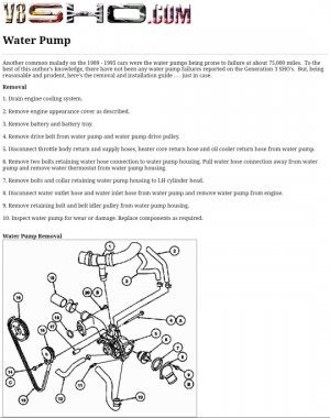

Okay the car was fine for about a day and then it started losing some coolant from a slow drip. I put a pressure tester on it today and saw drips from under the water pump. I used a mirror to try and see exactly where the drip was coming from, figured it could be from a weep hole. So, I started removing the entire housing assembly. There are only 4 bolts to remove but dang, I haven't gotten it completely off the engine yet because of the tensioner pulley. I figured if I could remove that pulley, it may give me enough clearance to manipulate the thing out of the engine bay, it's like a puzzle. Has anyone ever replaced a water pump on this engine and if so please share some tips. Gonna head over to V8SHO.com and see if I can find some instructions also.
Sent from my SM-S916U using Tapatalk
Funmart6
my name is mud
Apr 2, 2003
1,286
116
Auburn, Alabama
Wow, so I was actually removing everything correctly without any instructions but I just found this on V8SHO.com.
I just have to figure out the combination to removing the short rubber hose of the inlet pipe in hopes that will allow enough clearance to remove the whole housing. 54789e8390d60b59afc3ed9e0f680c0166740e0e336aa0fab612f94ecf37c9c8
