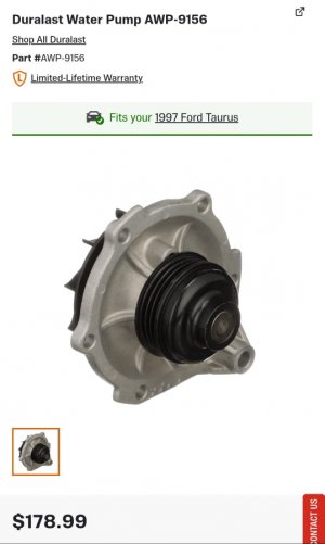

In searching for a suitable replacement water pump, I see that some listings say the impeller rotation is "reverse", some say impeller rotation "clockwise", and some say impeller rotation "standard" even though they all look the same and state they are for a 1997 Taurus SHO 3.4 liter V8.
I know these engines use reverse flow cooling so, what gives?
The Duralast water pump sold at Autozone actually sounds decent, is reverse rotation, and the impeller is aluminum. I'm not sure if it comes with a new gasket though.

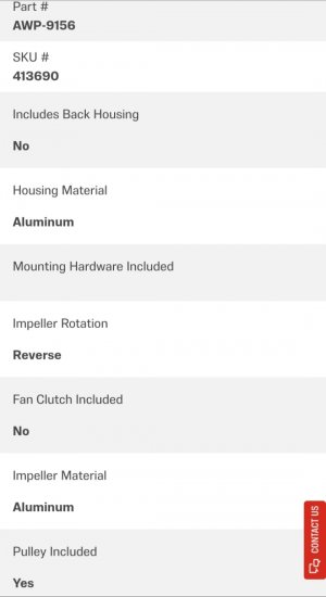

So to be totally clear about this, can someone please confirm that I need a water pump that states "reverse" for the impeller rotation. I haven't got the thing apart yet to examine this.

There is only one water pump for the V8 SHO.
I understand there is one specific style of water pump for the SHO but my confusion is that there are a lot of them on ebay that say they are for a SHO but some say standard rotation or clockwise rotation. A few say reverse rotation.

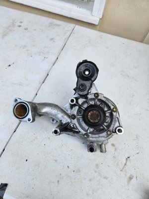

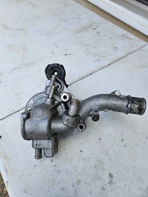

Finally had time this morning and removed the water pump, housing and all. Now to find a suitable replacement. 255d9ef902c27f098ca419ff53c9ad7859dca4c13ec6fb67814ff550b29e94fc

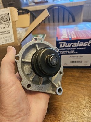

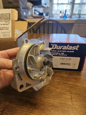

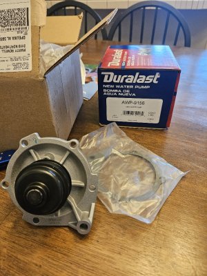

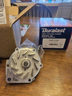

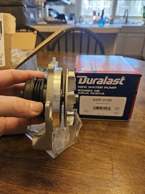

The water pump arrived this morning!!!
It came with a gasket but it is a crappy paper type of gasket. The pump itself looks good, feels solid, and spins smooth. The metal gasket I removed is in perfect condition and I will probably use it, I don't like the crappy paper one. Here are some water pump glamor shots!!! 9ef01b6af77f393659a6f053100ca6c29bcb9d5849f1edd56a6edbeff11ec3244836206ff8469aa735e8a34ee8e86f23Cad132722f65e9d4caec5337c4a5838eBa25564ed9bceceaea0ccfeb74de425f

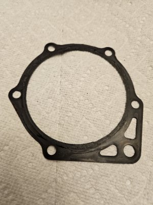

I have been all around both sides of this gasket with my phone camera on 3x magnification and I do not see any part numbers at all, even at 10x, nothing. It is a metal gasket and has a thin black coating. 7fcecabb4f1c594c326a5fb1dee3b4acB89904ae18421794cabd65d4d43bcba7
13,287
5,169
Probably need a ford parts person or maybe the v8sho mailing list people have the part number. You might be able to reuse the original but it is really old.
