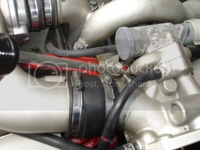

OK, just to mke sure I'm doing this right, I'm running a tube from here (where the screwdriver is pointing, a few inches to the right of the metal tube that runs into the upper radiator hose)
DSC01470

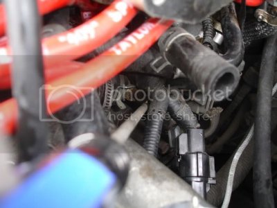

to here (again, where the screwdriver is pointing)
DSC01472

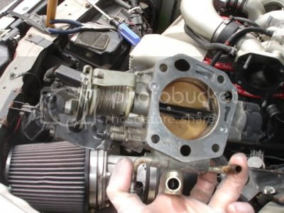

Or phrased another way, I'm taking the tube that connects to where my thumb is and connecting it to where my ring finger is. DSC01473
I just want to make sure because there is another tube down there and it's the same size as the other two, but I can't see where it comes from, or to where it connects. It kind of loops out from under the intake, and back to the same area.
