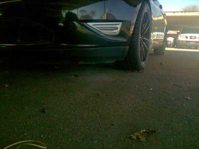

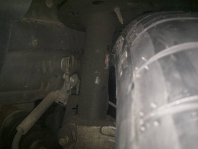

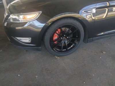

So after 2 years of mulling over wheels/tire combos, and months of measuring, and offset calculating, I finally got my wheels/tires. 20x9.5 Konig Oversteers +40mm offset. with 275/40/20 Cooper RS3-S all the way round. Fit could not be anymore perfect on the front. Just installed one to ease my mind on the front strut clearance. And I have 3-4mm of clearance. On the fender side, they fit perfectly flush. I'll get them all installed tomorrow when my hub rings, 3mm spacer plates and slim lug nuts come tomorrow.
And, BDP, I was very close to getting the Nt555g2's. The BFG Comp 2, Cooper RS3-S and Nt555g2 were my final 3. 1f129b9b29333e2b47ea725a725ceae88744b7437de6004883570600b5e69cf8773fbb8dc6213ca5db2fb16bc17b6ea6

Glad the setup has turned out as you intended!
Now get out there and enjoy them.
Wheels look sharp and I've heard decent things about those Coop's.
But for me, I couldn't pass on the deal I got on my Nitto's.
Suffice to say we're both happy!

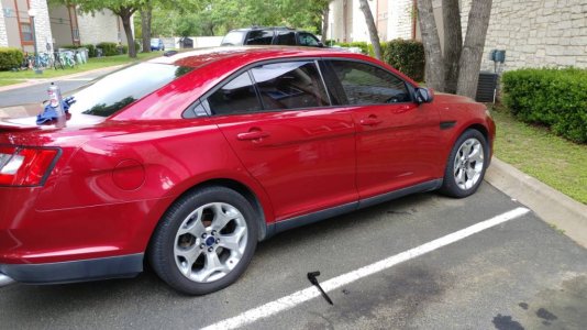

Took mine to local body shop to get the hood painted. When she gets back I will finish buffing out the rest of the panels and polish her up.
