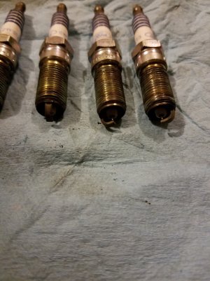

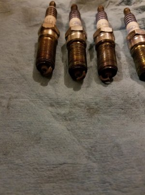

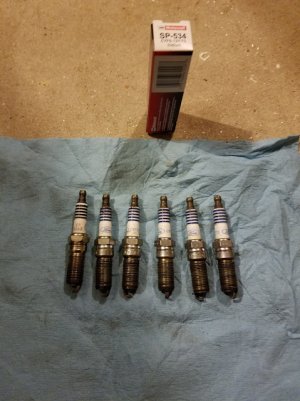

Replaced the plugs today as well. Found 5 Sp534's and 1 Autolite XP8363 in the cylinder heads. Previous owner or dealer was probably hunting a misfire and replaced the one plug. Too bad they gapped it at .050. Gap on the 534's ranged from .037-.043. Needless to say, I replaced the plugs with 6 brand new Motorcraft SP534's gapped at .030. Car runs fantastic!
Was it replaced very recently? Was it gapped at .050 or is that what it measured when you removed it? As plugs get older they deteriorate and the gap increase. If you measured it at .050 and it had been there for awhile it could have been gapped much smaller when installed.
The listed gaps were my measurements when I removed them. Plugs looked fairly fresh. I'd assume they'd been in there less than 15k miles. Car has 69k on it now so it kind of makes sense if previous owner swapped them around 60k. Prior to me changing them, car felt like it was down on power and didn't pull like I thought the car should. All is well now, car runs like a scalded dog.
