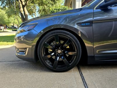

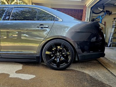

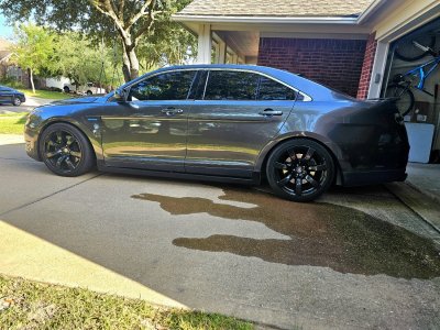

I installed H&R springs and pp shocks and struts on my non-pp sho yesterday. And it's a very solid firm ride. I have to get used to driving a lowered car again because while I was driving around, my rear tires scrapped the fender liner 2-3 times today. I love the way she sits now!6f1beb01eeef1561d83b62d4a2f2788832a7e36ff97cd4e1585a57aa9059e1a0082dfc8b2fc562f1179e20c3ed92336a

Looks good. She’ll soften up a bit after a few hundred miles. Outside of looks, the improvement in body roll alone makes it all worth it.

Thats awesome, what are rims? A have a few im looking at installing.

They are stock wheels from a Nissan GTR. Well, technically, I bought 2 rear sets of GTR wheels so that I could have a square setup of 10.5 all the way around.
