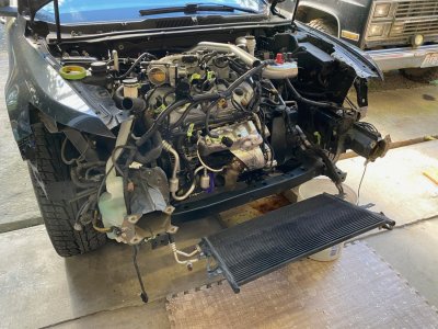

Started tearing it apart... Will be posting a part out ad in the near future. Have just about every bolt on upgrade you can get for these engines, GH turbos, Xtreme DI HPFP, Xtreme DI injectors, PPE catless down pipes, GH intercooler, EPP piping/filter, Tial BOV, methanol injection, etc., you name it, I probably have it. All have less than 2,000 miles. Should've figured my tired stock block 120,000 mile engine wouldn't last long with all that I've done to it. Scored the cylinder wall which created major blow by.

If you go for a new engine. Find one for a pp or a police interceptor one. They have a special hardened top ring since the cops start it cold and stomp it down the highway. Thats the engine i put in my 15’ non pp when i scored the cylinders. No issues since.
Talking to the ford quality guy here those top rings dont grow so much from heat as the 10-12’ and 13’ non pp and up.

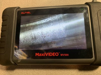

A look at my worse cylinder at the time.
