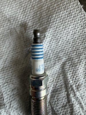

I did check the gap on the plugs all were 0.026. While prepping the car for a 2,500 mile trip I decided to take all the plugs out and inspect and sure enough cylinder 3 had a crack in the porcelain. I’ll be gone for 10 days so I’m going to see if Matt can ship me a pair of plugs to where I’m staying in Wyoming. The fuel will be a lot better there as well, it’s a shame because they have a bountiful harvest of e-85 and I’d love to run this thing regularly on e-30.
