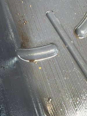

Well, I did a fluid drain and fill. Five in five out. Fluid was pretty brown, lighter than any of the times I’d changed before. Considerable metal pieces. 7798ab29e3ad1b8dbe7c7ddc7d367d06
