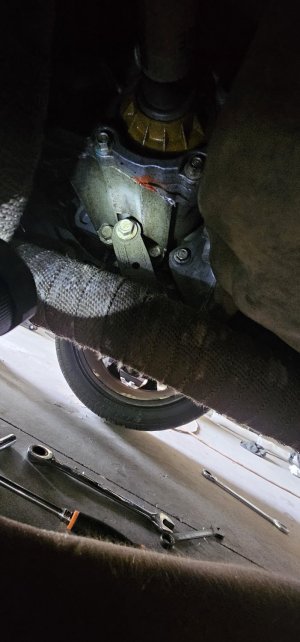

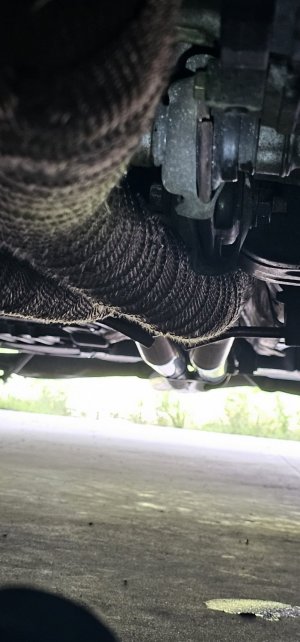

Was giving it another go today, and running into same issue. Thinking main source of the issue is the exhaust wrap, but wanted to make sure I wasn't missing something. Was going to pull this bolt above the trans mount to see if it gave me any wiggle room but figured I would confirm with yall before moving forward.
76FoMoCo
Nov 22, 2018
1,808
1,943
Nampa, ID
the wrap might make it tough. you might be able to put a floor jack on the trans and lift it up just a bit and the mounts will move but undo the other bolt first.
