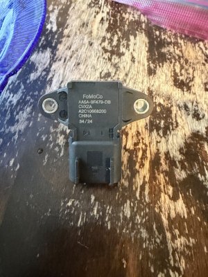

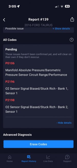

Recently installed GH ao tune with dp, did my plugs, thermostat, and 3 bar. Tune loaded with advance trac and collision warning off, started up and sounded super weird, had no power or shifts. Reflashed, worked, and was running normal. took it for a 10 mile drive to see if the shifts would smooth out. Got home, turned it off and back on, same thing happened. I repeated this process, the second time letting it idle when there were no lights, etc. Still did the same thing after everytime I tried to restart it. Flashed it back to stock no issue. Any idea what happened? I had codes p0106, p2196, p2198. Did I get the wrong map sensor? IMG 0311

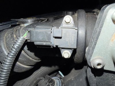

If the one on before my throttle body is a 3 bar, is the distinction between a 2 bar and a 3 bar the square on the left side of the sensor?

Recently installed GH ao tune with dp, did my plugs, thermostat, and 3 bar. Tune loaded with advance trac and collision warning off, started up and sounded super weird, had no power or shifts. Reflashed, worked, and was running normal. took it for a 10 mile drive to see if the shifts would smooth out. Got home, turned it off and back on, same thing happened. I repeated this process, the second time letting it idle when there were no lights, etc. Still did the same thing after everytime I tried to restart it. Flashed it back to stock no issue. Any idea what happened? I had codes p0106, p2196, p2198. Did I get the wrong map sensor? View attachment 96445

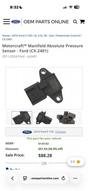

Im pretty sure this is a factory 2 bar sensor. You need the CX2594 from rock auto.

The map sensor on the tube before the throttle body is a 2.5 bar map sensor. It can be used but it’s not a 3 bar map sensor. And you have to be specific about these things to your tuner.

Your original picture of the suspect "3 bar map sensor" doesn't look like an OEM part to me. The markings don't look right.

Following up, took me a bit longer than expected. Re uploaded the tune and put the new map sensor on. Drives like a charm. No more sputtering or hard shifting. Thank you all for the help!
