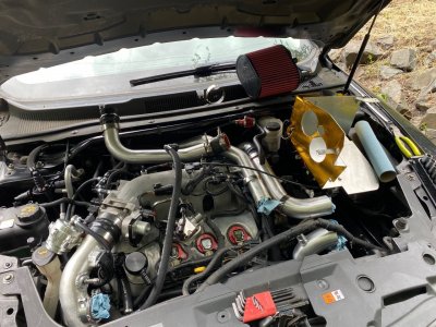

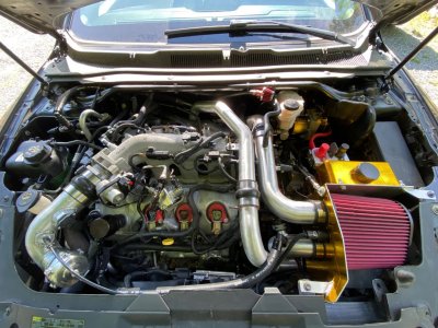

I think I'm going to move the condenser out of the way as much as possible and spray down the intercooler. My Intercooler is one of the earliest Gearhead units that I got from JordanR.
Then the fans are coming off and I'm spraying down the radiator.

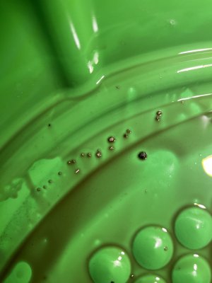

Did the third drain and fill today. Jacked up the rear as well while it was draining just for *****, and got a little more out than usual. Only put 6 back in, and it looks good on the dipstick, and it’s driving fine, so maybe I was a bit over-overfilled previously. Found the usual glitter and dirt in the drain pan, but saw these chunks this time. Wondering if this is within “normal” ranges given the fact that when I did my first drain and fill the fluid was clearly old, and most likely the original…(maybe they’ve been in there and jacking up the rear just let them flow out this time) or is it time to take it in to ford and see if it’s about time for a new one (still under warranty)?
C0BBD19F 6F44 488D 8288 82B99E7CADD6
RickyRecon
Apr 23, 2022
170
214
Northwest Indiana
Transmission not engine fluid correct?
Yessir. I know some is normal from wear and tear, especially the flakes, and “dirt”, but I wasn’t sure about these chunks. Probably hard to gauge correctly from the picture, but they aren’t big chunks per se, and there wasn’t a lot, maybe a couple more than what was in the pic. Just not sure at what point size wise it moves from normal wear and tear to “time to have it looked at”. Could also just be stuff being “flushed out” due to cycling the fluid and I’m being paranoid lol

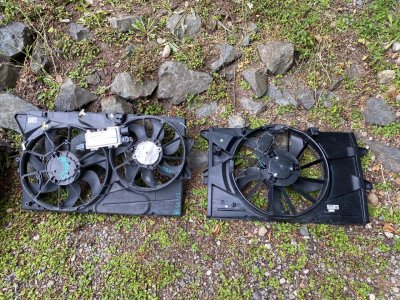

Finally figured out my overheating issue which would occur randomly on hot days. Long story short 2010MY have a different fan plug than 2013+ MY. Took a lot of digging with little to no info online. Basically there's no aftermarket companies that make the correct fan assembly (two fans not just one) w/ the correct plug. All the aftermarket ones are single fans which are crap & have the fan motor relay originated incorrectly. Ford dealer wants $1,800.00 for the fan assembly which is the highest I've ever seen for any car. Even Tasca & Rockauto have OEM ones listed at $1,200.00... Sourced a used one through eBay for $180.00.
What a pain just to replace a fan. Somehow managed to remove the fan assembly without removing the top coolant hose.
Rad1
Correct OEM fan on the left and to the right the crap aftermarket one w/ fan relay zip tied from the original location just to reach the plug.

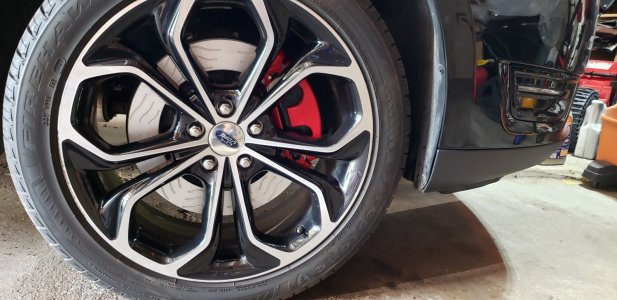

New brake rotors, pads all around: Raybestos R-300 High Performance rotors and Akebono ProACT Ultra Premium Ceramic pads. Also, new Powerstop calipers up front.
Same rotors I went with when I swapped my 2010 to 2013+. Seems like they've been good thus far.
