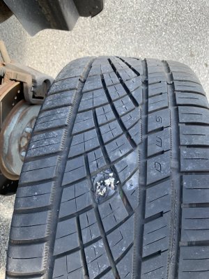

It was a bad day for the SHO. This happened...
4FC6DAED 96EB 4A16 A2F4 542AA1F79ABF
But, not before this...
FBD3C589 A8D9 4F79 B59D E3F86422E5AA
So, to add insult to injury the 100K milestone was turned over on a donut on the way to Tire Rack to buy a fresh Conti DWS 06 only to watch it get shaved down to 7/32”.

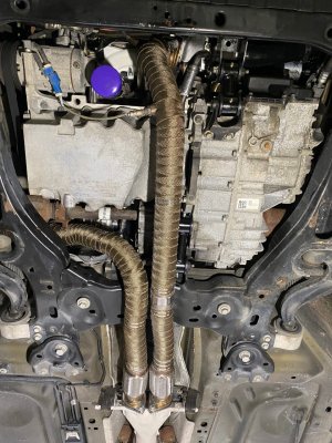

Finally got some time to wrench on my car after what seems like forever w/ parts sitting for months.
Started w/ removing front turbo in preparation for GH turbos.
T1
T2
Now onto removing the exhaust manifold (2010 MY)
T3

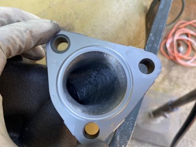

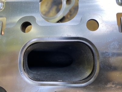

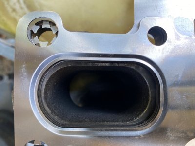

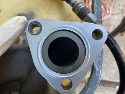

Decided to port match the new 2013+ manifolds.
T4T5
T6
T7
Still need to do a final sweep on the ports but you get the idea.
T9

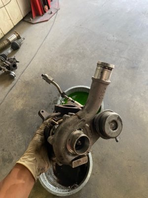

The main reason for me going down the rabbit hole... Blown rear turbo causing excessive smoke. Not bad though, 125k hard miles on them. Going to tackle this one tomorrow. Oh and as a bonus you can see the EPP inlet pipe and how tight the tolerances are. This is w/ the CV axle removed.

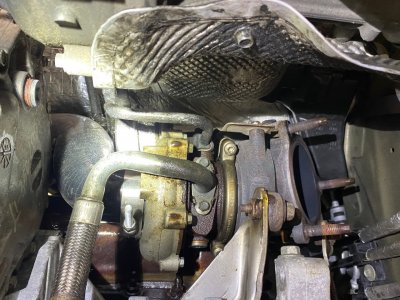

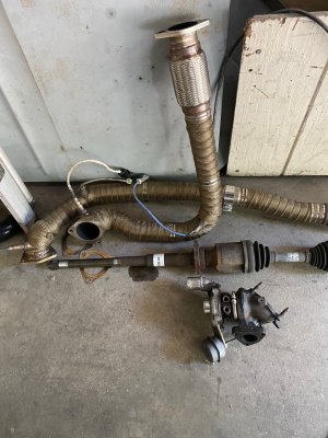

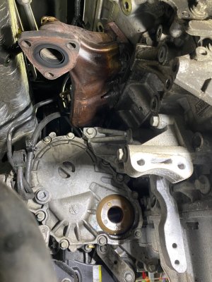

Removed rear turbo. Honestly was dreading this but it was a lot easier than I thought. Literally all I removed was the CV axle and it practically fell down. Didn't have to move the engine or drop the subframe a little from what I have read. Hardest part was probably removing my EPP setup or the heat shielding on the manifold.
TT2TT1

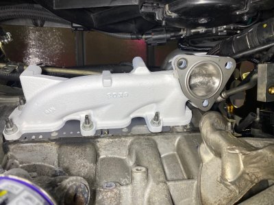

Once the rear turbo and manifold was out I decided to start working on the front & install the 2013+ manifold w/ new hardware. Figured I slap some hi-temp paint on it.

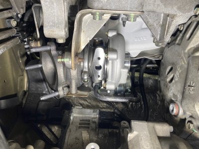

Installed GH turbo.
S2

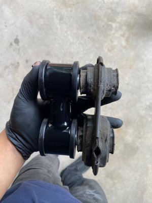

Mandatory Anthony mounts, comical when you put it next to the OEM ones.
S3

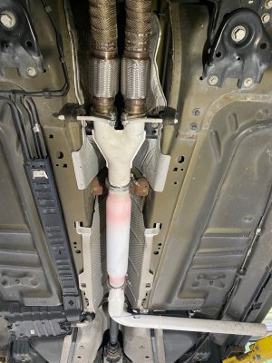

Installed exhaust. You can see the mid section (resonator) has v-bands so I can switch out for a straight pipe or another resonator without hacking up the whole exhaust.
