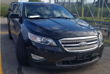

jman1200
Dec 5, 2017
695
644
Ontario

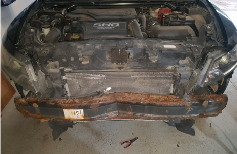

Well, about a month ago my son decided to reshape the front of my SHO against the back of a pickup truck. He perfectly centered the plate to the truck's hitch:
Capture
Bumper cover and grille cracked, both headlights broke internally, impact bar bent and radiator support cracked. The condenser and radiator got bent in but luckily they didn't break.
Capture1
1660059502558
Didn't want to go through insurance as the damage is not structural and parts can be easily swapped. Insurance here is crazy expensive and if I put a claim in, his insurance would go above the $500/month mark.
Found all the parts from another 2010, same color so hopefully I don't have to paint the bumper. Got new headlights which were already burnt and foggy by the sun.
Took it apart last night and replaced the rad support. This thing is made out of fiber glass so now I'm all itchy...
Hashe389dda3b0866b3ec80f6a0db977039f
1660059884020
1660060046566
Hope to be done tonight.

jman1200
Dec 5, 2017
695
644
Ontario

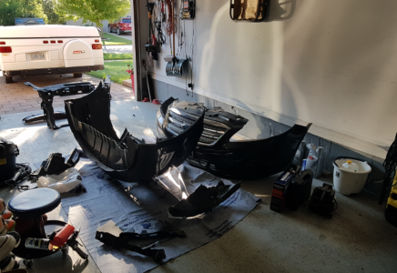

All done, good as new. I still need to paint the upper grille to match the one I removed:
1660226664086
1660226736746
Here is everything I replaced:
1660226765968

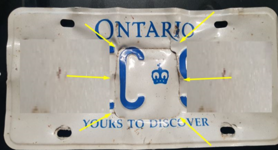

Point of impact. You can see (hitch square) how my son was able to perfectly hit the pickup right in the middle...
1660226902942
Gonna get new plates later today. Keeping this one to hang it on top of his desk so he never forgets...

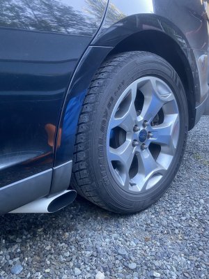

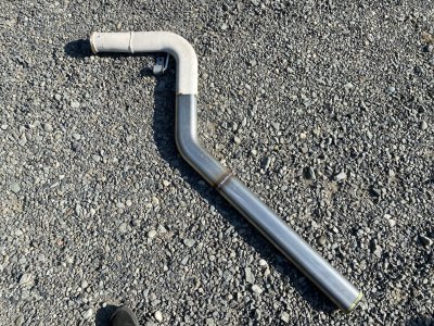

Re-did my exhaust setup. Was so nice having my resonator on v-bands, literally had it out in less than 5 minutes. Even with a two foot glass pack resonator (Thrush) it was raspy when you get on it and had a pretty bad drone. So I got not one but two Vibrant ultra quiet resonators & welded them together. I tried one and it’s kind of crazy how much of a lower rumble/growl it made it. A lot of the reviews stated that but that was all V8 cars and figured it wouldn’t do it to something like our little V6s. I didn’t want to add a “muffler” as I wanted a straight through exhaust setup. I then re-did my exhaust side exit now that I got the correct elbow. Also should be getting my tires this week so I should be able to slap on my new rims & hopefully do my coilovers.76CEAF23 19AA 4C36 951A C767BC5A5D96

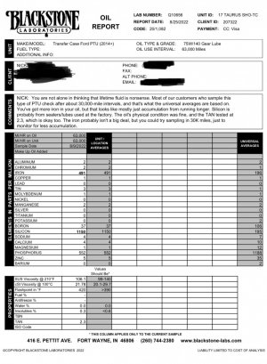

Heard back from black stone today about the factory PTU fluid sample I sent them. Much to my surprise, after 63k miles, it was in relatively decent shape. I’m still going to change it at least every 12k miles going forward, but it’s good to know it isn’t falling apart yet haha.
