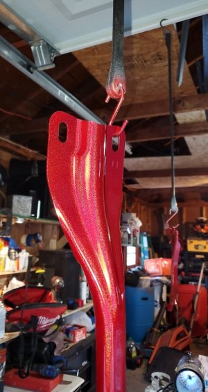

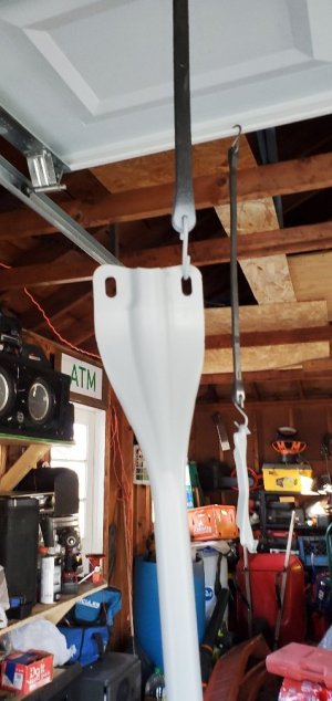

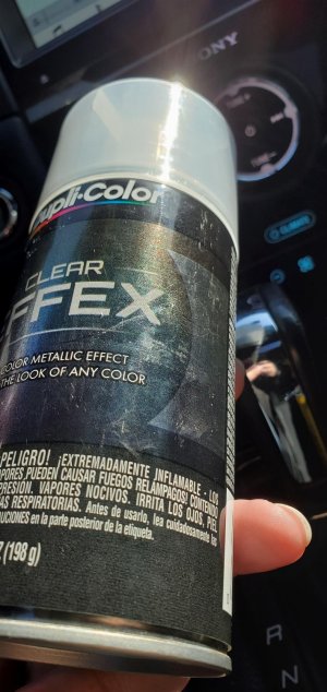

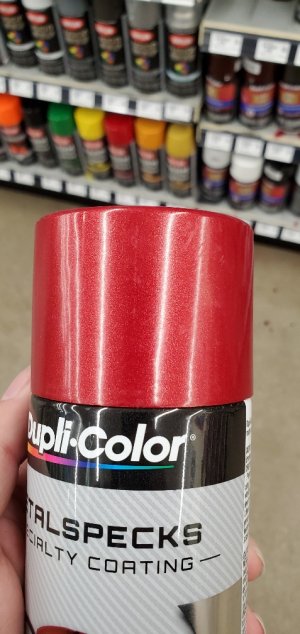

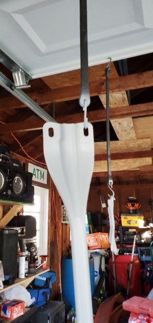

Decided to paint my strut brace and battery tie down today, was bored. Pretty happy the way it turned out i will post a after pic as soon at its dry to the touch 7b190e4dddc6cf272655d9217387399f05d2e29ef7ff33024e5f9ee485386c7050f111034bfbb443e0ac108155c610724e01e07416f8cb071b9c1a519ea22d24
LOVING THIS!!!
Since my car is going to be ripped apart I think i'll do the same and include the battery box and intake mount. Well done!

Thank you! I'm more the DIY guy more than anything I'd rather do it myself then buy it! I'm excited to see your build once you're started

Well....where are the end result pictures!?!?!Tltngqatejy1xibhyr12i0xqjd5g2zht63aqaq8pridgiphy
