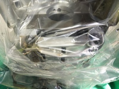

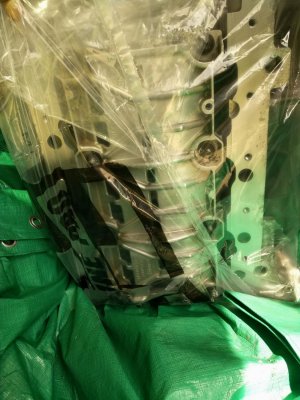

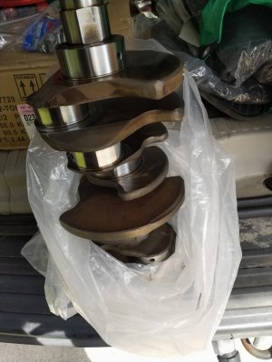

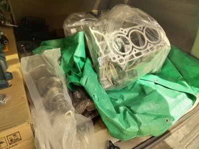

Got my block and crank back from Holbrook Racing engines. I drilled and tapped the outers main holes from a m9 to the m10 to accept the Livernois/ARP hardware for the 2018 blocks. I Also drilled the outer main cap holes and windage tray holes to accommodate bigger stud hardware. Had the mains align line honed, crank journals polished and both hot washed. Cleeeeen

ARP doesn't make the correct size studs and bolts for this block, I take it?

They do but they don't have a kit that they offer. I called them. They said "it's in development, should be out by the end of this year"
Livernois has kits that they spec'd from the ARP hardware catalog . I told them my bolt specs and year, and bought the LMS kit. I got the studs home and realized the outers didn't fit. (Though I told them the correct specs and year). I went back to exchange them and they told me they don't have the 9mm studs anymore.(grrrrrr). They told me to just use the inners and use factory outers. Much stronger than stock. But who wants to keep $150 worth of hardware that's not usable. So I drilled and tapped my block to fit.

That sucks, but bold move tapping the block bro, I hope it worked out!
