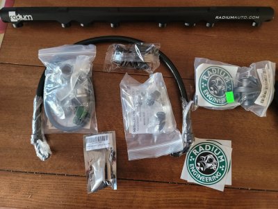

Lexus Update: I bought a new rail, new feed line kit (e85 compatible), new fuel rail dampener, fuel pressure regulator, electronic fuel pressure gauge, and other goodies. I have some things going on this weekend, so hopefully in the next couple of weeks I will get it all installed and we can really turn this trash up. HAHAHA.
Also going to throw some new plugs in and inspect the old ones. Still go to work on the big bottle CO2 pressure regulation as well.

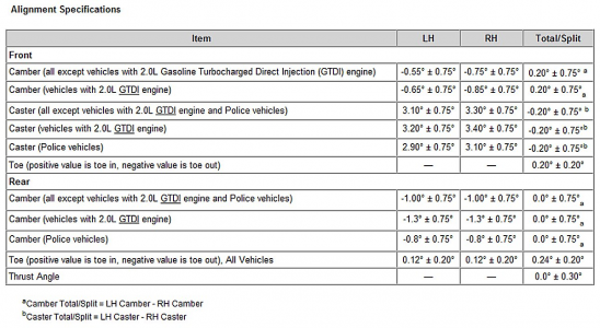

I would take a copy of the alignment specifications with you. The SHO is kind of odd because the left and right do not mirror each other. Also request that they use reduced tolerances. There is a setting on most machines that will limit a "green" result to only half the factory tolerance. The final thing I would consider (purely preference) there is a different specification for the Police Interceptor. You may consider how you drive/the purpose of the SHO to you and if you prefer those settings. The SHO will be more for "comfort" as it was sold as a DD and the Police Interceptor will be more handling/performance as it is designed as a duty vehicle and with pursuit driving in mind.

Thank you for the information. I will probably tell them to put it into the PI spec because with the H&R's it isn't the softest ride lol.

Thank you for the information. I told the Lincoln Dealership to put it into the PI spec and they did. It was really noticeable right off the bat. It turns in faster in IMO. Going on a road trip to Kommiefornia on Thursday so I will get a pretty good run with the new spec.

About a month ago I had to replace some of the tires on my SHO. I got roughly 40k miles out of my Conti DWS 06's. Completely happy with them. They have been a great tire, so I stayed with them and the got the DWS06 Plus. Still a great tire may I add. My car did need a front alignment. @Ta2dResqr posted the specs for our cars and included the PI spec. Since my SHO isn't my daily, I told the Lincoln dealership to put it into PI spec. They did.
When the tech brought it around, he commented that he really liked my car. He was probably mid 20's. Kinda cool he knew what the SHO is. As we know, most people don't. So we chatted for a bit and I went on my way. Right off the bat I did feel a difference in the ride, and car does feel a bit more agressive on turn in. My GF made a comment about how different (in a good way) it was.
