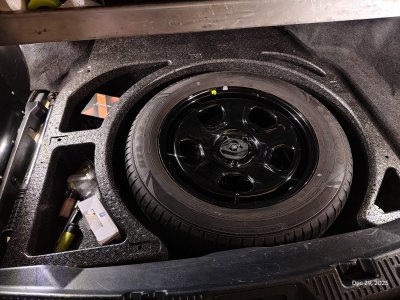

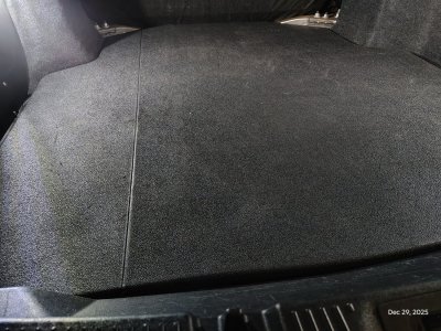

Find a PI sedan in a junkyard. They have a styrofoam insert to hold a spare tire and a flat floor cover. The 18" full size spare fits in there. The 20" wheel and tire is approximately the same size and may fit as well.

From experience the 20 does not fit in the well, seems to be a smidgen wider or tall enough to not fit fully on the bottom. I turned the well space into a tool box and keep the spare above on long trips.

I have an 18" cop spare, don't recall the size of the spare tire right now but it's about a 1/4" shorter than the 245/40/20 road wheels and it's too tight to fit in the spare tire well.
