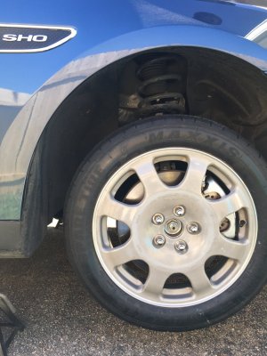

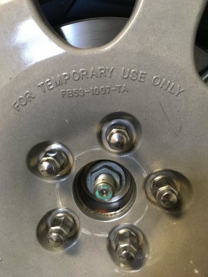

Picked up an alloy 18" mini-spare T-165/70D18 from an Ebay salvage yard off of an Explorer FB53-1007-TA.
Also picked up the jack assembly and the plastic trunk retaining nut from Ebay as well.
Did front & rear test fitment, but never drove on it.
IMG 1976IMG 1068IMG 1069
