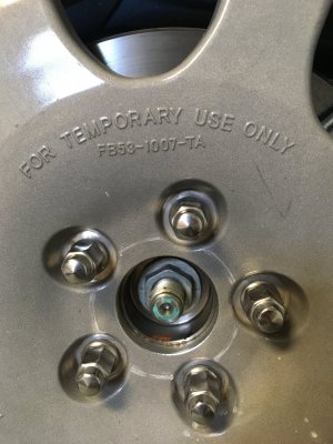

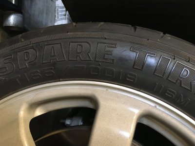

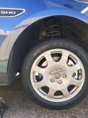

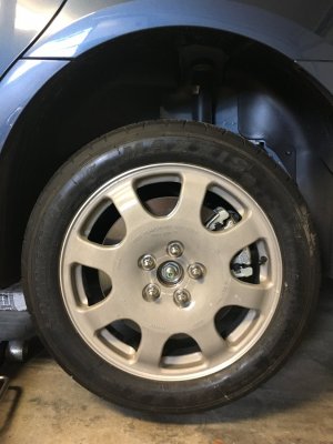

I have an SEL and a SHO PP. I believe the SEL's 17" spare (-11% diameter difference vs the stock 245/45 20) was a little too small for the SHO's AWD system, compared to the 18" spare.
So, I went with an 18" alloy spare from an Explorer on Ebay, P/N FB53-1007-TA, with a T165/70 D18 tire, with a closer diameter to the stock 20s (-5.6% diameter difference). I've never used it, but installed it on my PP's rear wheel location to test fitment/brake clearance without issue. (See my pics)
Don't forget, to complete the OEM-looking install, you will need a jack/lug wrench kit AND the jack retaining bracket and nut. Some kits include the bracket and nut and others do not.
FWIW, the Flat/Inflator kit that came with the PP has a sticker on it that says not to exceed 50 mph. So technically, both options are only good for 50 mph.

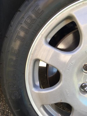

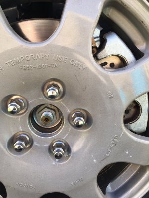

Finally test-fitted the 18" alloy wheel on the front of the SHO PP. It cleared the calipers and spun without issue.
Below are a few pics for reference:
(P/N FB53-1007-TA, with a T165/70 D18 tire)
Thanks, that will be where I head if the 18" steelie from my Exploder doesn't work.

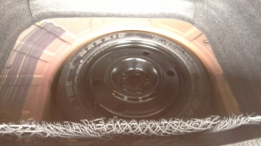

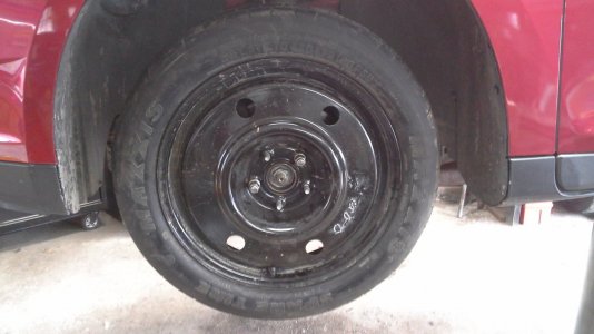

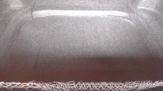

Had some time to tinker with this today, and I can confirm that the 18"/27" steel setup from the '11-'14 Explorer will clear the brakes and fit under the cover in the trunk.
20220423 150950
20220423 153322
20220423 153248
Grabbed it from my local junkyard for $20. I noticed a Limited and a SEL there when I was there this afternoon, so I'll stop in Wednesday and grab a anchor/jack kit.
