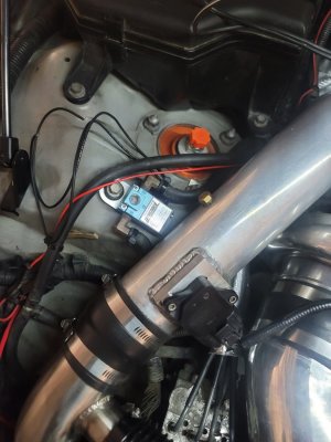

Long terms goals: wire in the mac valve and let the Haltech completely control boost. This is allow us to set up different boost groups, enable a scramble feature, and possibly dabble with anti lag

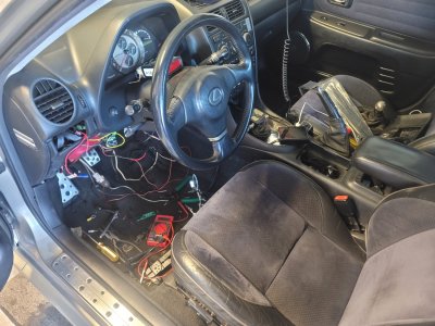

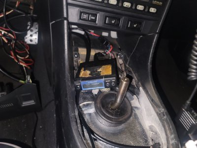

Lexus Update: So a couple of updates. First being the failure of my boost gauge. It just quit. Won't power on. So I bit the bullet and bought a Turbosmart E-boost Street Electronic Boost Controller. Install was pretty straight forward. However, I had to navigate a jungle of wiring mess, move things ect. That being said, I did get it all installed. I want to run the boost control through Haltech, but that will be further down the road. The Eboost unit will do perfect for right now. I got all the settings and targeted boost levels for the low boost group and the high boost group done within 10 minutes. I have settled on 17 psi for the low boost group, and 26 for the high boost group. It is really nice because when the air temp changes the manual boost controller cannot adjust and I would go into overboost. I would have to pull over and manually turn the boost controller down. Now I just have to punch a button and turn a K.N.O.B. I did get to my threshold of 26 psi, and then I went to log it. At that boost level, cold weather, and e50....the 350 lph fuel pump was starting to struggle. It wasn't lean lean, but I wasn't happy.

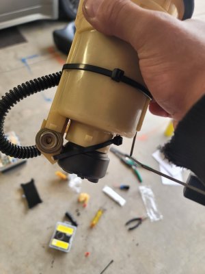

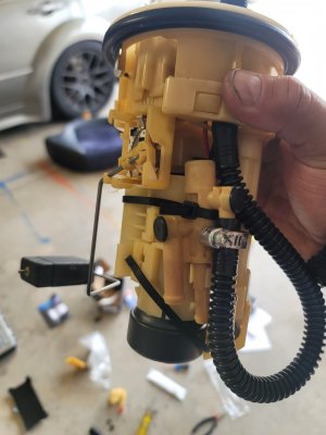

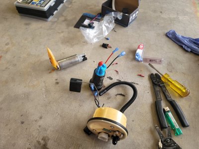

Lexus Update: So after watching the 350 lph fuel pump struggle in the cold, I knew it was time. I bought a 525 lph in tank pump and added that to the the mix. I did have to modify my pump assembly. So there was some hacking. However, I got it all to fit and modified and dropped it into the tank. Went out and ripped her on 26 psi, and she was perfectly happy.

All them electrical intestines splayed out. My ADD brain went into full vapor lock looking at it. Good job.
Hahah, I knew the monster that was lurking. However, I did tame it ....kinda.
