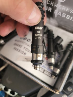

For fuel injectors I went with DW 1000 cc injectors. These will allow me to run more fuel, more boost, and make the power level I think we can hit with this step up. DW said they were direct replacements for a stock Lexus IS300 and they were right. However, the connectors were not, so I had to address them.

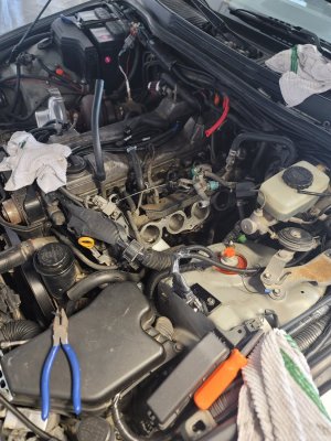

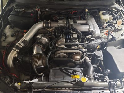

Lexus Update: I started the tear down. Here is a picture of the engine buttoned up.
20220407 203816
I removed the charge pipe, throttle body assembly, middle piece of the intake, and then the second piece of the intake. There is actually three pieces to a 2JZ-GE intake. Yes three pieces, they are hideous looking however, they do work pretty good. After the last piece was taken off, I removed the stock fuel rail, injectors, fuel line, and all other vaccum and coolant lines.

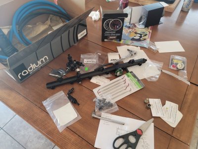

All the parts on the table mapping out how I will run the lines and fittings.

DW 1000's.

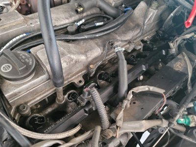

Fuel Injectors and Fuel Rail Installed.
20220907 155523

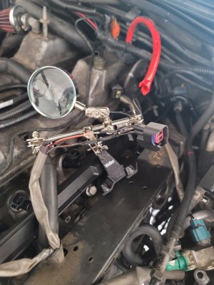

I started re-stalliing the fuel rail and injectors. During this time I changed the spark plugs and reinstalled the coils and wires. Everything went pretty smooth until I had to start soldering connectors for the new injectors. I have an older soldering iron that was not up to the task. So I purchased a new soldering gun and it went very smoothly. Having the right equipment is half the battle.
Helping hands doing their job for the soldering job. These are a must have if you solder. Trust me.

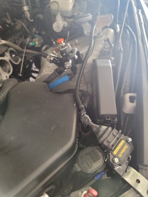

Installed the new fuel pressue regulator with all fittings where the Haltech Triple Channel Ignitor used to live. I relocated the ignitor towards the front of the engine bay and way from the heat.

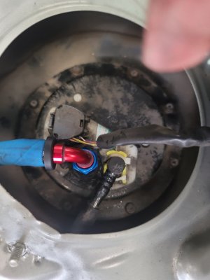

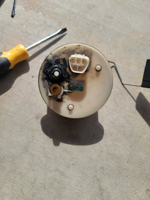

Next I worked on the fuel hat. I drilled and tapped it and installed the bulkhead fitting. I would replace the original one that I bought with a different one later. It was just a better piece with better washers. I also was having issues with the line that attached to the bulkhead fitting to the jet pump. It kept kinking, cutting off return flow and was making the bulkhead fitting leak on top. I have since changed that line and it works like it is suppose too, however it isn't ethanol compatible and started getting greasy lol. I have a ethanol compatible corrugated line being delivered today, to that will fix that problem.
Picture of the bulkhead fitting installed in the fuel hat.

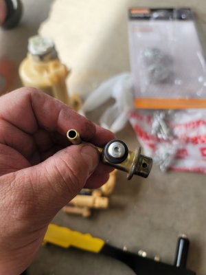

Picture of the stock regular blocked with the pop rivet.

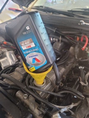

Then I changed oil. The oil was pretty clean, but it was saturated with fuel. New Valvoline VR1 goes back in with a K&N filter.

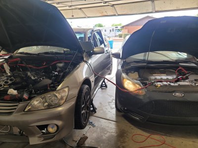

Put the intake back together and went to prime the system to check for leaks. The Lexus was dead. Pulled in the Focus (because it was the only car that fit) in and jumped the Lexus. No major leaks expect for the bulkhead fitting which is fixed now.

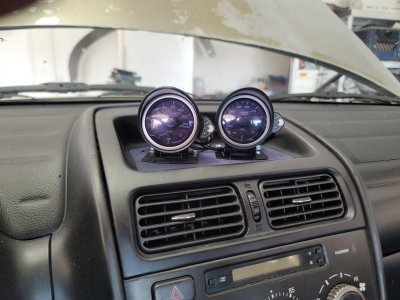

Installed the fuel pressure gauge in the car.
