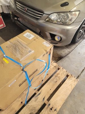

Elmhurst Toyota called and told me that my new 2JZ-GTE short block has arrived, and that they will be shipping it to me ASAP. So it is time to start collecting the rest of the parts to make this thing compete. I don't know when I will start the swap but, it will be sooner than later.

FYI. A 2JZ GTE short block weighs 285 lbs, and should be delivered 4/18 ish. I have been thrashing and beating on the old motor, and the knock or whatever isn't getting worse. So like a mailman, I keep sending it.
