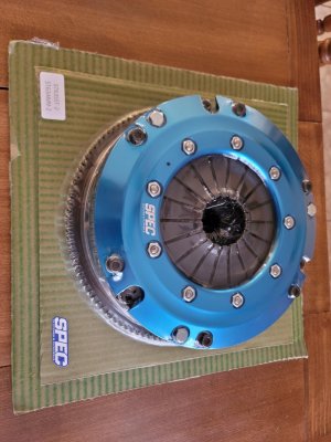

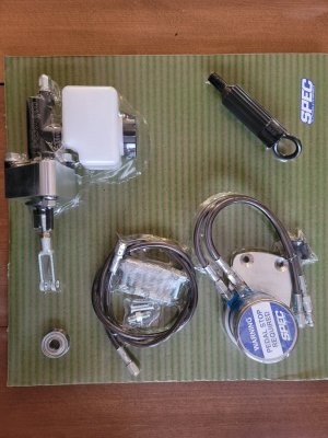

Lexus Update: So I bought a complete twin disc setup from SPEC Clutches. I priced out a complete McLeod Twin disc setup and it was $3300 before taxes and I would need to modify the front plate on my R154. Ouch. I read some good things about the Spec Twin Disc. SPEC says it will hold 900 lbs of TQ and is a direct "bolt in" so I pulled the trigger. It was $1796.56 shipped to my house. So yeah, going to start pulling the trans on Thursday. I will post on pics of the clutch and install later.Screenshot 20220222 113739 Message

Lexus Update: So I bought a complete twin disc setup from SPEC Clutches. I priced out a complete McLeod Twin disc setup and it was $3300 before taxes and I would need to modify the front plate on my R154. Ouch. I read some good things about the Spec Twin Disc. SPEC says it will hold 900 lbs of TQ and is a direct "bolt in" so I pulled the trigger. It was $1796.56 shipped to my house. So yeah, going to start pulling the trans on Thursday. I will post on pics of the clutch and install later.View attachment 83160
