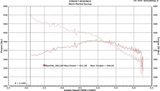

So...final MOD update on the SHO. Threw her on the dyno for the first time since I put the HPHP on. With the stock pump and E30 and FBO she put down 391 hp and 494 tq. With the HPHP and revised AJP tune she cracked off 411 hp and 546 tq. Finally the 400 barrier fell. Lol what a fight. Remember this is with worn out stock turbos too. The dyno tech said he pressed the record on the dyno a tad late and missed the actual peak tq but he said he expected 555 to 560 TQ. So yeah. Extremely pleased with the set up.
So FS HPFP and revision netted me 20 HP and 52 TQ to the tire.
