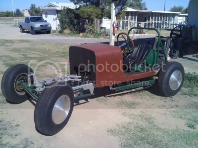

I have pics of that project on my old computer. That vehicle is beautiful.

Dont yell at me, PLease....Im into the retro look, so....no injection.
The aformentioned bellhousing...
0201091344a
An early construction shot.

Has anyone ever carb'd a SHO motor before? I've never seen it done and frankly, I think it's pure sex.
I know you lose the magic intake tuning, but I still love the juxtaposition of old and new like that, and the coolness of taking a motor that was designed from the ground up to be EFI and slapping a plenum and carb on top and calling it a day.
It's a "backyard engineering" masterpiece, in my opinion. Nice "cam sensor". :)

TY for the assist on the pics...
I was thinking of putting a Ronald Reagan Bobble head on the end of the cam so He spins around when the engine runs....
I have a Megajolt box to run the ignition and use the stock coils. The rear water manifold and interior water transfer tube are gone and my thermostat is in the top hose at front.
I could write a book about all that has happened to the engine...
0201091344a
gotta say i really like the setup nice work...
