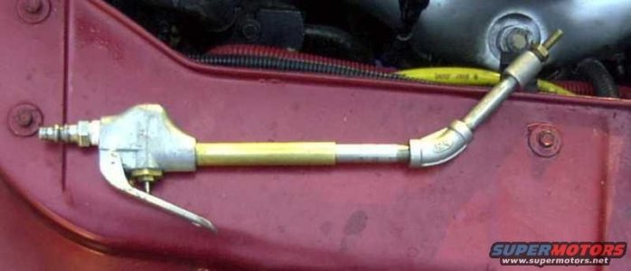

The cam lobe presses against a shim. The shim sets on top of a bucker. The bucket sits on top of the valve spring.
So one of the cam lobes has a missing shim under it.
You need some special tools to take the shims out.
Blow gun adapter

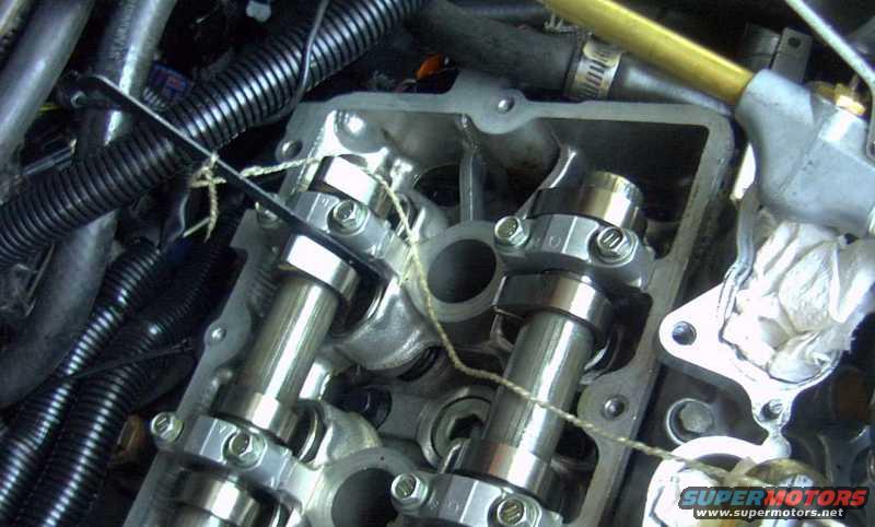

Checking the clearance is done with a feeler gage.
Valve clearance check
The pics of tools looks like from dr. Mengel's workshop.
I did it all with 1 big screwdriver and feeler gauge.
