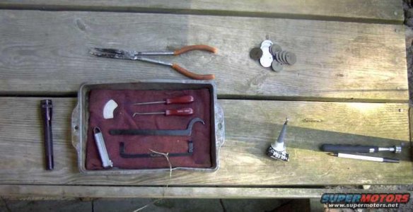

You need some special tools to take the shims out.

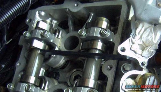

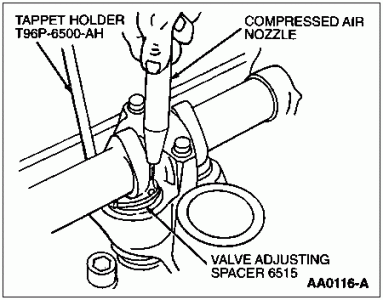

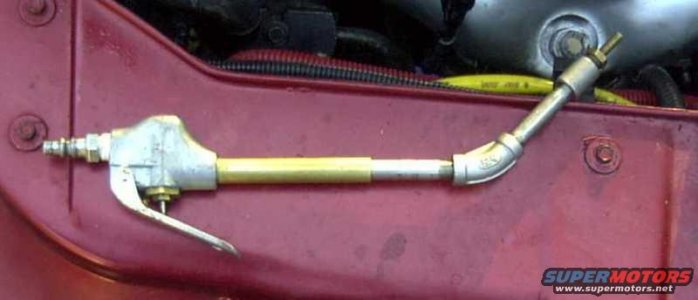

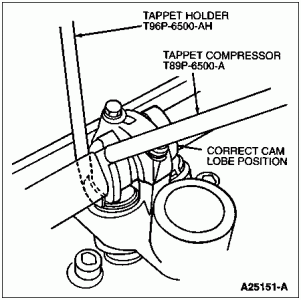

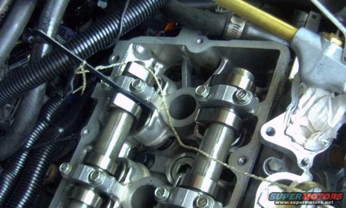

Valve adjusrtment tools
Blow gun adapter
Tappet compressor placement
Tappet holder placement
Tappet compressor
Tappet holder
Shim removal with compresed air
Checking the clearance is done with a feeler gage.
Valve clearance check
