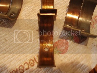

Yes do them ASAP this is mine with 197,000
Bearings003
The one that almost spun
Bearings020
If that doesnt make you want to change them i dont know what will!!
