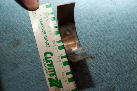

Plastiguage is hair-thick plastic that deforms under pressure. You stick a thread of this stuff on your bearing, torque the puppy down and see how much the plastiguage deformed. It will tell you your current bearing clearance.
It comes with it's own chart. Take the smushed plastiguage and compare it to the chart. When you find the line that's the same width as the smushed plastiguage, that's your bearing clearance.
When I did my first rod bearing job, I measured my rod bearing clearance with plastiguage before AND after swapping the new bearings in. I was able to tell EXACTLY how sloppy my old bearings were compared to the new ones.

Well, maybe I can still be useful. SuperHO, here's an example of plastigaging:
CRW 4881
