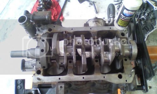

Was a core required? That is a great deal regardless.
Tom
Yeah, $40 core. Not really worth the shipping and time to return for mere 40 bucks but I'll return it anyways to keep the process going. My crank if is in great shape, just scratched where front seal is, can easily be machined out. If they run out of cores I'm sure there start jacking the price up.
Ishodu
Jun 26, 2002
5,077
615
Ontario Canada
Do you know you can repair the scratched seal area with a simple speedy sleeve? It would be far less work than replacing a crank.
chrism3784
Jul 4, 2007
577
87
West Palm Beach, Florida
yeah, but I wanted to replace it anyways. Motor has over 160k miles on it and couting. Wanted new main seals and such and nice surface for them to. Couldn't pass up the price!
