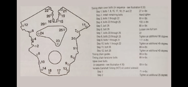

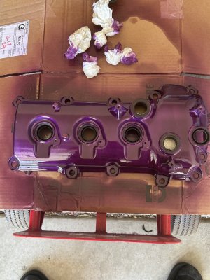

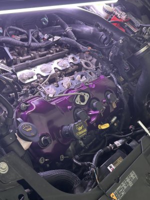

Ok guys after the exciting adventure I am deeming the problem fixed. I replaced the water pump and problem has went away. Here’s what I took away and all I did, replaced timing chain and guides, replaced phasers with new updated ones, replaced all tensioners (serpentine belt one included), added the updated mailings oil pump and new pick up tube. Replaced every gasket from timing chain cover RTV bs, all the way up.
Water pump seal had started to fail and was leaking but I park on a moving blanket in my garage or in the street if available but never noticed it with the splash shield catching most of the drip.
Also for fun I painted the valve covers. Included some photos,
Also few parts I had to replace along the way consisted of coolant reservoir hose to the engine has a double tab plastic piece on one end and as soon as I gave it a pull it snapped right off. Belt tensioner was locked up to the point I couldn’t take belt off and forget about putting it on, not common but just things to look for along the way.
Also I did all this on the ground engine in the car with a floor jack and night stand. No special tools are needed IMO. You will need a pulley puller, as for pulley installation tools most I found didn’t work for out crank pulley because it’s caved in, so once the center nut goes so deep you can’t get a wrench on it and you would need insane sized socket to reach it do to length of the bolt it threads on. Best advice use it to get it started, once u can no longer use a wrench, remove and place cut 2X4 on it and tap it down (good luck), it does work though but once close enough use original bolt and get it started as deep as u can then impact it on and it will pull the pulley on into place.
