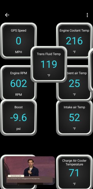

Does this coolant temperature seem high for a 2010 SHO with ~211K miles considering the low outdoor temps and 30 mins early AM trip (20ish miles at interstate speeds and .75 miles on surface streets)?
Water Pump and Timing Gear changed February 2021 at ~155K miles.
No signs of leaks, oil looks normal visibly with no Blackstone Labs discrepancies, HVAC heat works well, AC works okay in summer (slight leak in AC system and a black car in the deep south are fighting all day), no CELs/codes, and no dashboard temp guage fluctuations in any weather/driving conditions.
Data is displayed by OBDLink Application dashboard and OBDLink MX+.
Picture 1 is immediately after arriving at destination.
Picture 2 is 8.5 hours later prior to departing destination.

does seem on the high side. thermostat should be fully open by 203f, iirc. so either it is not opening fully, or the fans are failing. have you checked the fans?

I haven't done any testing outside of listening for fans, visual inspection for leaks/unusual things, and checking codes. Since I wasnt sure if it was unusually high, I didn't want to get too crazy deep in diagnostics.
I know the high speed fan setting runs and I will have to check the low speed side. I think FORScan on my garage laptop will help since the Android App is hit or miss with me.
This was this morning at 1050.

fans should not come and stay on when you start the vehicle while at ambient.
the driver side fan (for a/c) will come on when climate control that requires a/c is activated.
passenger side fan should only come on when engine temp exceeds a set temp. so if that set temp is at or above 215f, then looks like there are no snafus. ecoboosts do run hotter than naturally aspirated.
one of the common tuning features is to turn fans on earlier and let them run longer to a) keep engine cooler, and b) save on/off cycles for the fans thus improving life.
