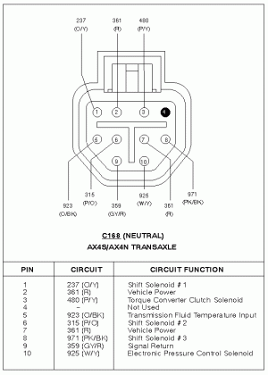

Do you have any pictures or diagrams of where I can find this.. and do I go at it from the top or bottom?
SHOZ123
Dec 2, 2000
12,152
673
Illinois
The side pan you get to through the drivers side wheel well.
