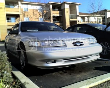

Just got the gen 2 and the plastic on the lens are yellow from age. anything I can do to clean them up or do i buy a set. I priced them at auto zone and they were $80 each.

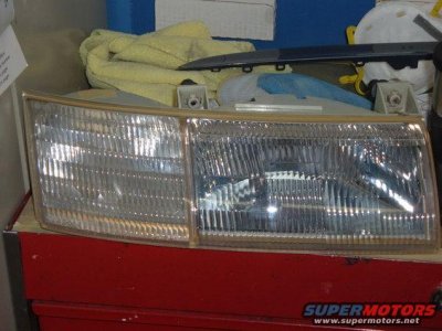

After the wet sanding and polishing, why not have them clearcoated? I suppose that would make it more expensive, but they would be OEM lenses, versus aftermarket ones
A SHOCal member did that to a set of lenses he picked up after wrecking his SHO. Sanded the lenses, (took the three bumps off too), etc etc, then cleared them. You still get the yellow from the old glue though.
