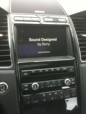

This is the type of unit I have
2010 taurus sony nav

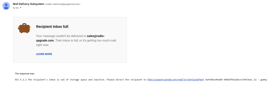

The only concern with that one is the reference image they use shows a standard non-Sony non-Nav unit but I'll contact them and see what they say, given the age of their unit I'd be surprised if anyone responds
