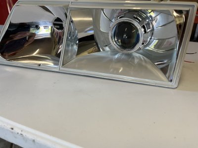

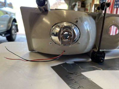

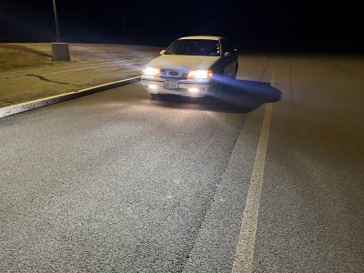

This is an option - bake them, pry the lenses off, mount projectors in them, epoxy them in, remove the lense nubs with a dremel, sand down the lenses and 2k clear them.
The knockoff Morimoto projectors worked well and they use an H1 bulb. So I went with a 30,000LM LED 6500k bulb. I’m not a fan of the color temperature, but that is what’s out there.
The projectors have a high beam shutter, so I had to modify the headlight wiring with a relay to work right. I also added a dc/dc voltage regulator to ensure no LED flickering.
End result is 1000 times better night vision.

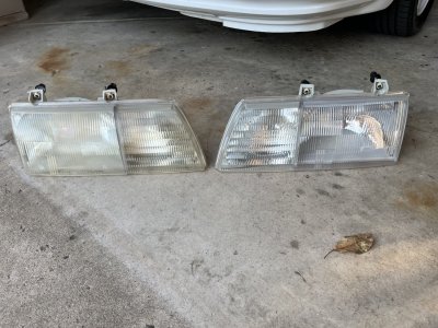

Here’s a picture of one lense sanded and 2k cleared and one faded/natural for comparison.
