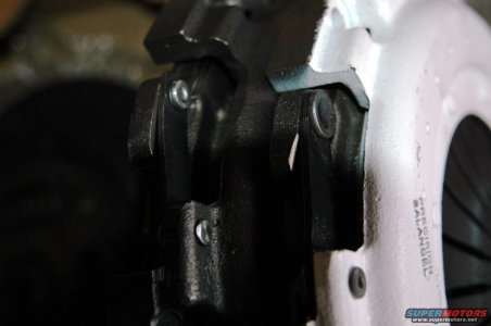

I am not sure about the Spec clutch, but the CM stage one uses the stock clutch with an upgraded pressure plate. The upgrades are stronger straps and larger rivets.
The stock pressure plate is on the left and the CM is on the right. You can see the thicker straps and larger rivets.
